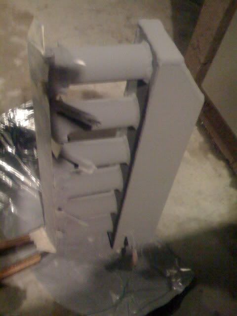

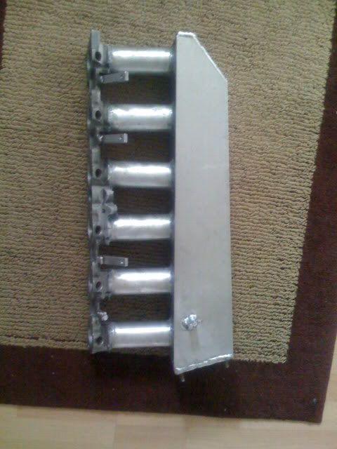

    custom intake manifold for BMW e30
    BEFORE
    DURING
    AFTER

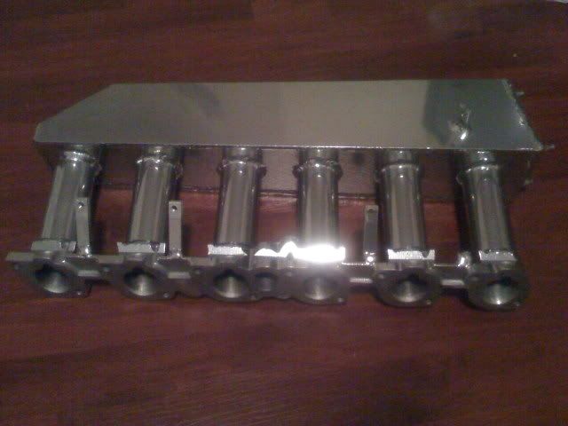

        Welcome to the forum. Nice job. Is it cleared yet?

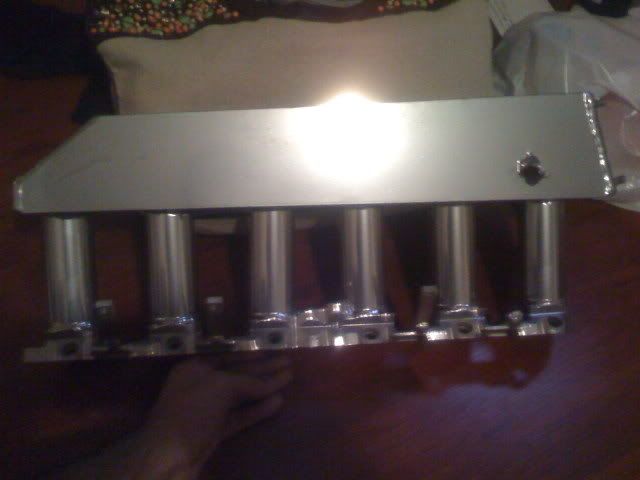

            thanks guys
            No clear, not sure if i should clear it. If i do any suggestions?
            Yea cured in a BBQ i know i know ive done a few parts (valve covers....) in it before and there still holding up great been over a year so
              Re: ultimate chrome intake manifold
              Whatever works! By the way, all the chromes need a clearcoat or they will tarnish and dull pretty quickly. Unfortunately, the clear will turn it into a nice shiny silver instead of the chrome finish you have right now. Either Diamond Acrylic Clear or the Glass Clear would work well.
              Best of luck.

                    I use the Super Durable Crystal Clear. And I'm getting ready to shoot the Mirror Clear over the Ultimate Chrome

                          yea its a m20 turbo people hate the fact that im doing this all to a 91 M Technic but its my car lol. I only have that one its the original manifold flange just cut off with 7inch runners.
                          I guess im gonna have to clear i dont want it to look like crap in a year. thanks for help
