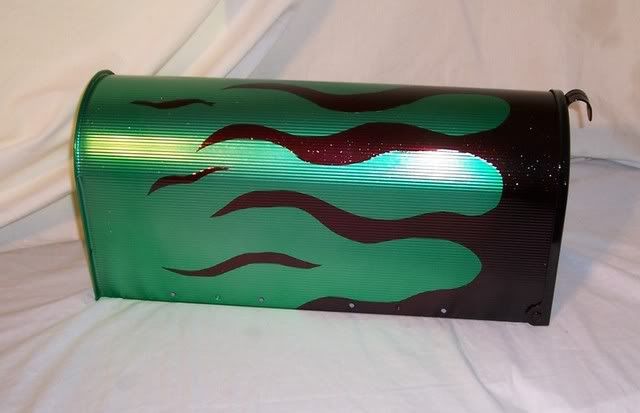

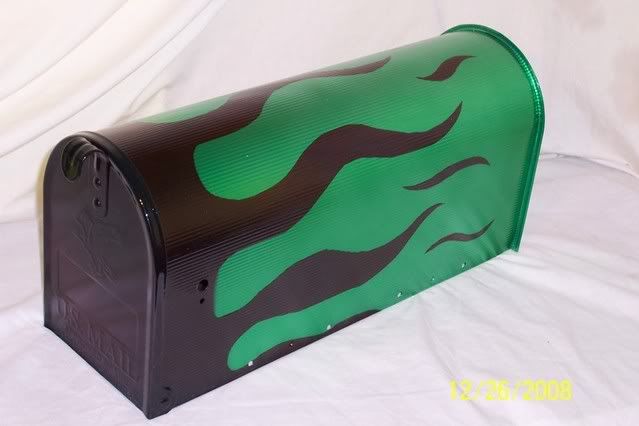

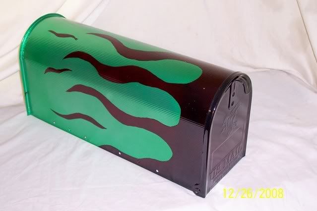

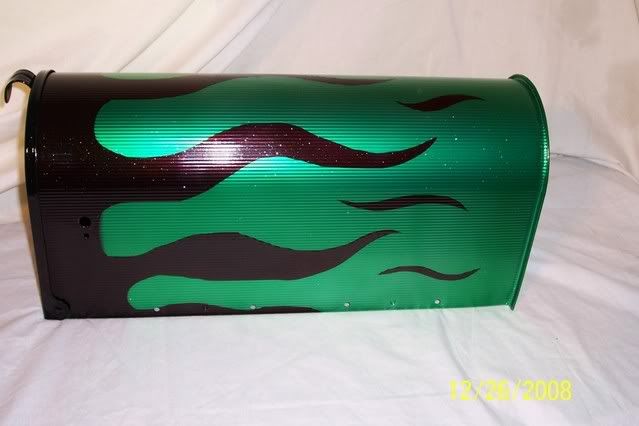

    Grabbed a New Mailbox and went to Town...LOL
    There are 6 coats of Powder..
    1.Satin Black
    2.chrome
    3.Candy Red
    4.Candy Green
    5.Clear with Silver Flake
    6.Second coat Clear with silver Flake

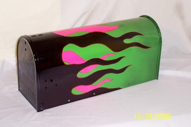

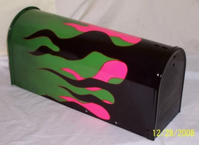

    This one has 9-coats of powder... Dark part looks black in pics but it looks like color changing in good light..you can see the candy red -purple and green..
    1.Gray
    2.chrome
    3.Candy Red
    4.Candy Purple
    5.Candy dew green.
    6.Neon pink
    7.Lime green/Fade
    8.Gloss clear
    9.Gloss clear 2nd coat..
    Same mailbox but Shot it with a Coat of Candy Blue.. Thats 10-coats..
