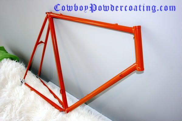

    Valve covers in Silver Stardust mini metallic with SD wet black fins/script.Road bike frame/Fork in EW Orange

              Those valve covers came out perfect!!
                Re: VAlve Covers and a Bike
                Thanks,i need to do a little touch up on the black as there is a little silver stardust on them.
                  That looks great. Did you use your finger to wipe the silver off before cure? I've tried it with mixed results. It takes an uber steady handy.
                    I did a combo of tape and finger wiping.Problem #1 is after finger wiping down the areas it still had some silver in a few areas,like on the lettering that i just couldnt get all the silver off so i think i might try Mek and do some little touch ups.I used the 1/8" tape on the fins which is the faster way for me.
