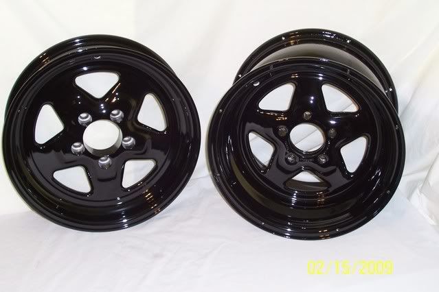

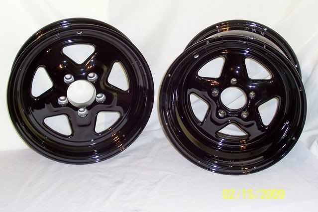

Prostar Drag Wheels in SD Wet Black...
  • Prostar Drag Wheels in SD Wet Black...
    SD Wet Black...
    Re: Prostar Drag Wheels in SD Wet Black...
    That black is amazing, HP. Nice.
      Great Job
        Sweet....Gotta love that SD Wet Black!!!!
          Nice job on the rims bro, smooht! Did you spray the required mils on them or did you go a bit heavy? How about the cure time. Cold or warm oven? And did u boost right up to temp with the oven?
            Here's How i did These...
            Started off with oven at 350-deg.
            Sprayed Them Cold with a good Medium coat, Put in Oven for 8-9 minutes until Powder started to Flow. Removed & sprayed another good Medium coat.
            Baked for 10 min at 350 , Then Crank oven up to 375 and Baked for 20 min Once parts were up to temp..
            After baking i Cracked oven door and let them cool in oven for about 10-15 min.
            Then removed them and Speed cooled them infront of a Fan...
