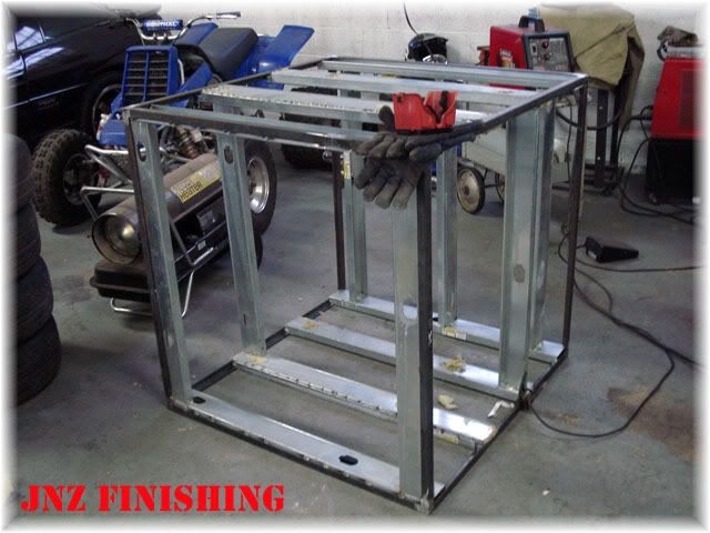

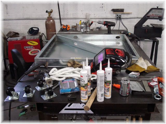

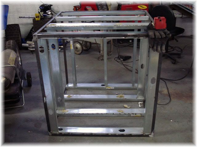

    Our new project: a ceramic coating oven Now we'll be cooking ceramic completely before it goes back to the customer. No more worrying about the ceramic getting over cooked on the car and flaking off.
    The beginning
    Materials

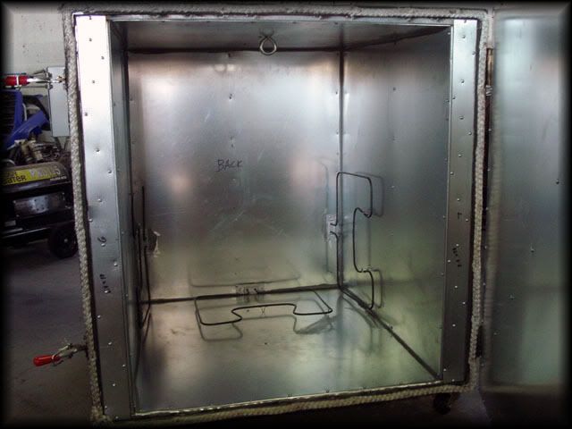

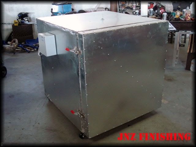

                  Here it is, 99% finished. Just waiting for the controller to arrive tomorrow.
                  Once its hooked up, the fun can begin, how hot can we get it
                    Re: Our new ceramic oven
                    Damm Joe thats sweeeetttt!!!!! Awesome job and goodluck man. Let me know how she cooks.

                      Good thing you labelled the "back", otherwise you'd be trying to push the parts in through that panel that doesn't swing open!
                        Man that looks great. Nice work! Are you going to shield the elements? seems to me you might have that same problem as in the other oven thread with hot spots. Do you have a break or did you get the sheet bent? and what are you guys using for insulation?

                          A friend of ours that has a fab shop has a sheer so I took the panels to him and he cut them for me, worked out perfect. Finding a place that had the right gauge sheet was tough, most places what'd alot per sheet but luckily we found a guy that cut us a deal because he was friends with our tech. Insulation is rock wool, specifically for hi heat applications. Found that at a local building supply place, pretty cheap too. Hopefully its enough to keep at least 800deg inside w/o any problems. Total parts where around 350$ or so, not too bad all said and done. Good amount of time and labor into it getting everything right but I think it will be worth it

                              Well the oven had its first firing tonight, too bad I wasn't there to see it. Its safe to say that everything turned out better then we expected Results???....How about room temp (65deg) to 900deg in 20 mins!!! and it was still climbing. This was with the door cracked open too. I'm so glad it worked in the end, definitely worth the money put out and the time involved. Now the next step will be to see how well it bakes ceramic.
