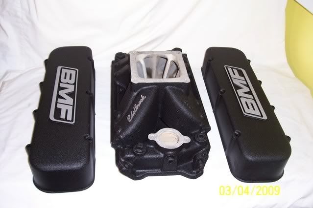

    BBC .. Intake & Valve covers... Black wrinkle.. Letters just blasted & Clear coated....

          I'm guessing you clear coated the letters first then shot the wrinkle black, correct?
          Nice job man, that looks really good.

            Excellent job bro! Must of took a little while to get the letters so clean. Brush? Finger....or what..lol.

              Juan]I'm guessing you clear coated the letters first then shot the wrinkle black, correct?
              Yep.. Sanded the ruff spots on the letters first, Then gave it a good Blasting.
              Then shot the clear & baked.. Then shot the Wrinkle..
                Not to bad.. Wiped right off with the magic Fingers...LOL
