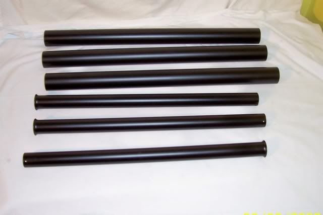

    Candy Blue Trans/with Electric Blue Candy Pearl Added.. Over Ultimate chrome..
    Flat Black..
