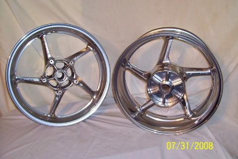

Ultimate chrome Motorcycle wheels...
  • Ultimate chrome Motorcycle wheels...
    Ultimate chrome ...No clear Yet ... Got a few Types of clear to try to help keep the shine..
    Re: Ultimate chrome Motorcycle wheels...
    So are these fully cured before the clear powder is put down? They look good so far man...

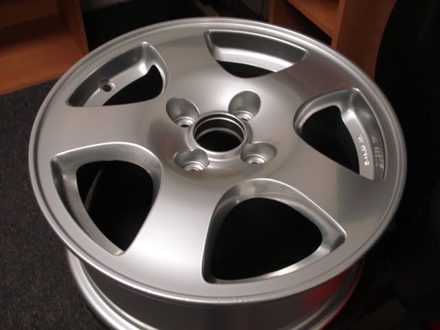

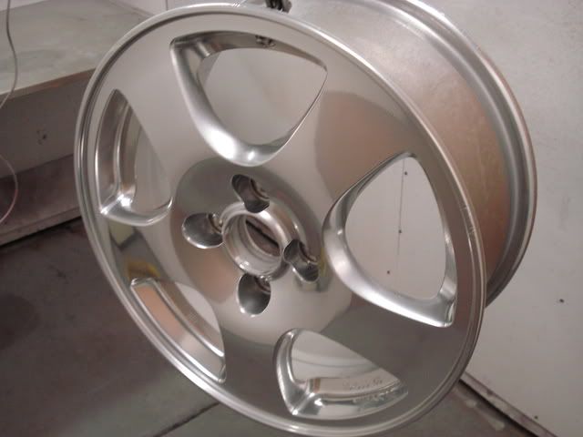

              Not the best quality pics but you can see there is a difference w/ and w/o clear:
              WITH GLASS CLEAR
              WITHOUT CLEAR

                  Thanks Dan. Even with the clear its still a nice finish but like I told my roommate, I'd rather have the clear on it so I know it will last then not have it and it look nice for a month then get scratched up or have brake dust absorb into the finish. Hopefully the customer will like it still.
