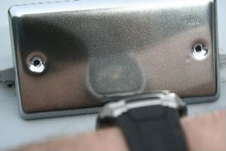

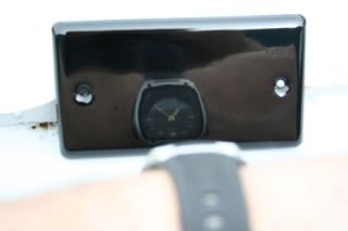

                              Ok here's a sample of my base. if this is not black and glossy enough then I guess I will just give up and give in now. I tried shooting several pieces today and none of them turned out worth a crap. I don't think it's in the process, I'm leaning toward the chrome I have, maybe there's something not quite right about it. Anyhow I'll post the base black, and then I'll post one of the chrome .
                              BLACK
                              Chrome Applied
                              You can see the results of applying the chrome. I have watched the ALSA videos a bookoo of times, and I'm following procedure and yet this is still the result. As of right now I'm at a stand still, I used the rest of my chrome today, so I don't know if I'll buy any more ALSA or go to another brand. Frustrating to say the least.
