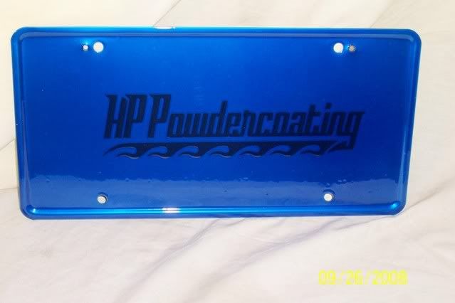

    Its the backside of an old License Plate..
    Scuffed it with Scotch-brite pad and wipe clean..
    Sprayed Chrome base coat , Full bake cycle.. Let it cool to about 130-150 Deg.
    Put Decal on and sprayed with Candy Blue.. Turned out Great as far as decal goes ...Not perfect finish , but i was not expecting it to be Because it was 3yr old powder thats been sitting in my Humid garage.. LOL
    Re: Vinyl Decal Test under powder coating Pic...
    Looks good. I've had pretty good luck coating over good quality decals as long as all the air bubbles are out from underneath. If not, they come out when you cure and make nice pinholes.
