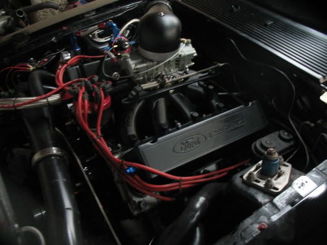

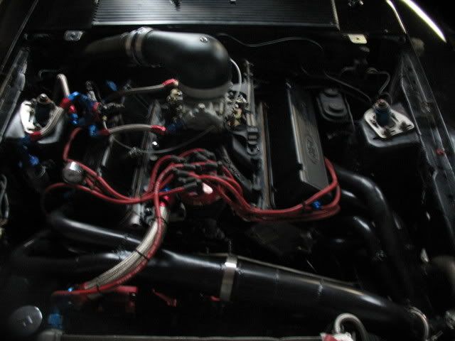

      Here's the Almost completed Engine Pic.. still have to do the Intake Tubing..
      BTW motor is a 427-ci SBF with F2 Procharger.. On the Engine Dyno It Made 1100-HP on Pump gas...lol

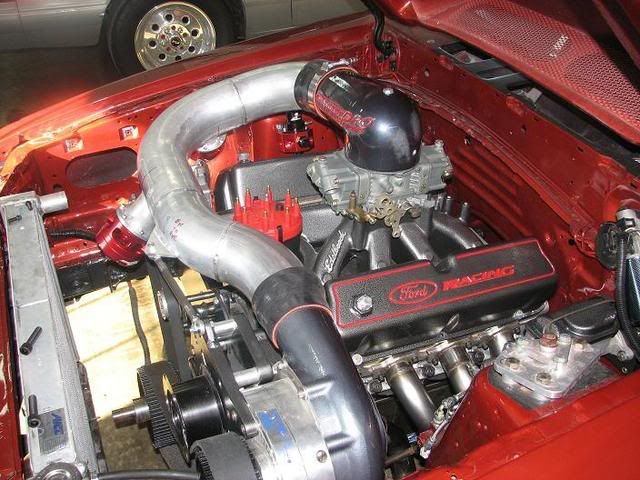

        Looks great HP.....must be a thing lately, those ford big block parts I did in Black Jack awhile back went on this (he was picked for doing the E85 shootout in St louis)
