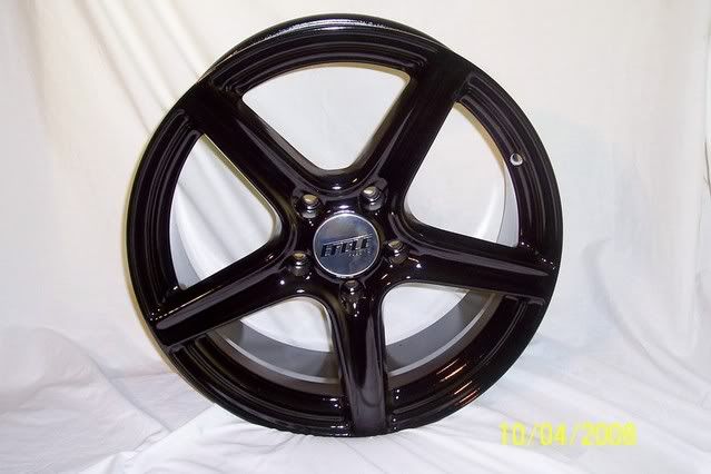

Bumper Black wheels...
  • Bumper Black wheels...
    One of complete set in Bumper Black....
    Re: Bumper Black wheels...
    how would you compare the bumper black to the mirror black
      When I shot some that I ordered I was not expecting the shine? They say that the mirror ones are very tough and I wonder if this is as tough or tougher than mirror ones? And with it being as shinny as it is and if its a shinny as mirror why was or what was it made for? Maybe PBTP can answer?
      Looks like mirror and wet black or the same as for as gloss and the bumper can be between 91 to 100% on the gloss and can be applied thicker? And has a good salt spray results. And its on sell at $5
        Nice job on those wheels man.
        I'm looking at a side by side of a Mirror Black and Bumper Black bottles, and it's really hard to even tell the difference. Gloss seems very close. The Mirror Black just seems a tiny bit smoother, like umm... a mirror. The Bumper Black just seems to have a tiny amount of orange peel, but that could just be the way I coated it.
        I'm very impressed with the bumper black though, especially after seeing these wheels.
