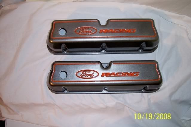

Three color Valve cover set...
  • Three color Valve cover set...
    Smoke Grey metallic..
    RAL 2001 Red Orange Lettering... Done with PBTP's "Liquid 2 Powder"..
    Diamond Acrylic Clear...

    OK, I'll be the one to ask....
    How did you apply the liquid powder? Any issues or tips you can provide?
        These Valve covers were done as Follows :
        Prep as usual..
        Spray entire part with the Smoke grey metallic, Full bake cycle... Let part cool completely..
        Mix Liquid 2 Powder/RAL 2001 I did closer to a 60/40 mix.. Apply with small paint brush,Let completely air Dry & wipe off any excess from Non-recessed areas. Then full bake cycle as per Time & Temp for RAL 2001 ... Let part cool..
        Spray & bake the Diamond acrylic Clear.... THE END..

          Good show. Those will look very nice when installed.
          Have you done any of the other parts for this customer?
              I Ceramic coated his long tube headers.. But i will be doing alot of his parts During the off-season..
