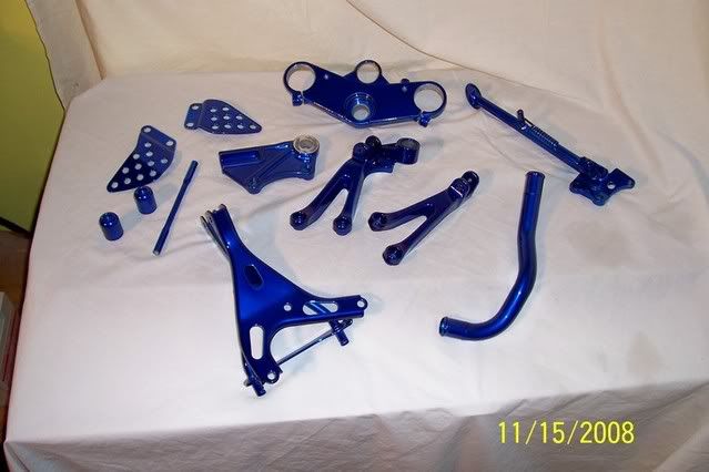

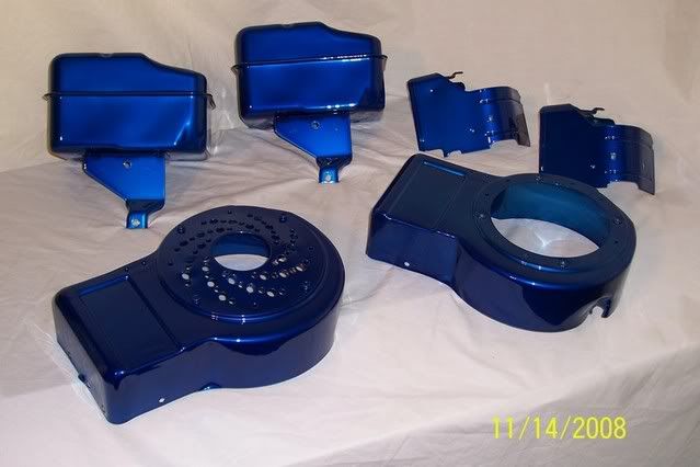

    Candy Blue Over CC chrome...

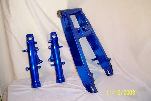

    Candy Blue over Polished Aluminum..
    Candy Blue Over Chrome & some polished Aluminum...

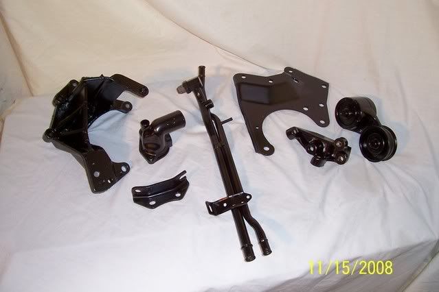

    PBTP Satin Black..
    More Satin Black...
    Satin Black/Polished letters ect..

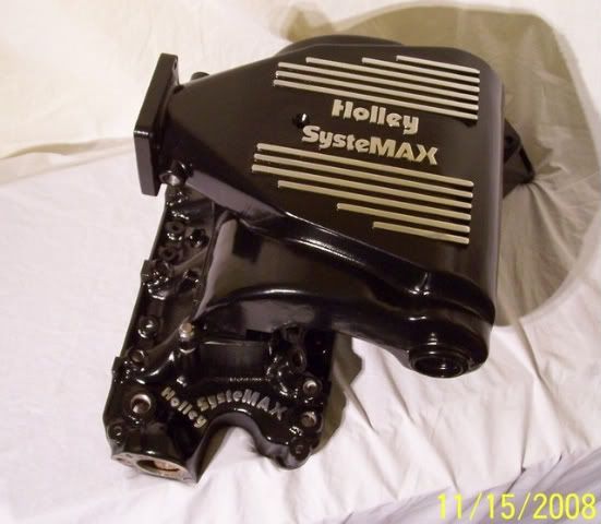

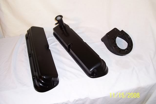

    Satin black Engine Parts..

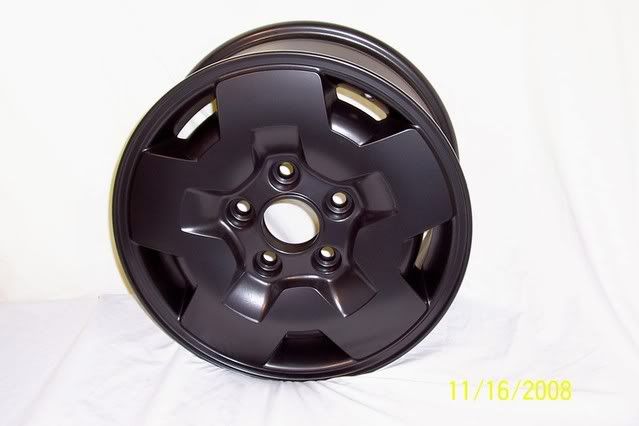

    1 of set of 15'' wheels in Satin Black...

      Very nice was wondering if you shot the blue right over chrome and polished alum. or did you have to use base powder?

        Any clear on the Satin 15" wheels? Got a customer looking for a satin black on wheels and I'm interested in a clear...
          Some of the small parts i had to put a chrome basecoat on first..
          But the Fork Tubes, Swing-arm and some small parts were polished already. so i just cleaned them good and shot the candy right over the polished finish...

            Juan]Any clear on the Satin 15" wheels? Got a customer looking for a satin black on wheels and I'm interested in a clear...
            No clear on these.. Just PBTP Satin black..40% gloss
            PBTP has a 40% gloss SD Clear that should give you about the same shine ??
