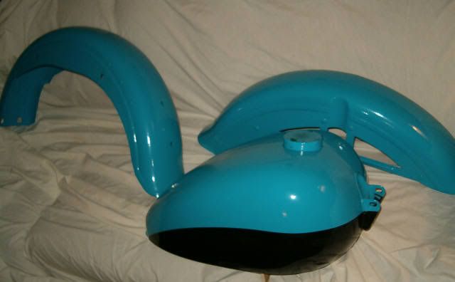

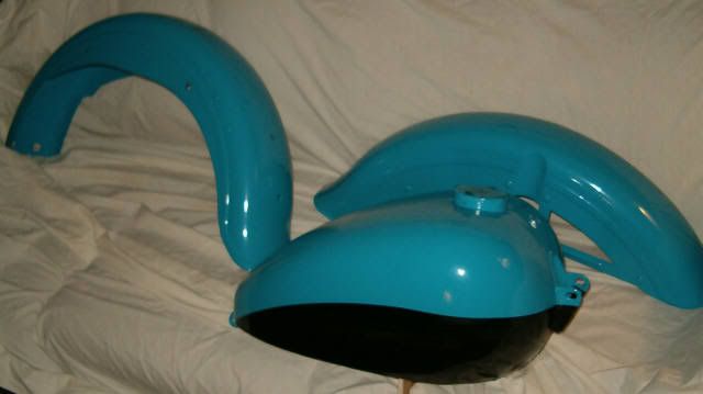

              Well, I took your suggestions
              I still need to wet sand them and clear-but so far so good.
              The cubic blue should be called cubic orange PEEEEEEEEEEL blue
              even the sample chip looks like crap. sorry, but I don't sugar coat poop
              oh
              this is the very first time I taped a line guys--I never even practiced one yet--lol
              I feel good about it. Thanks for the tips on how to do it smoothly.
                Re: Harley Davidson Fenders
                Looks great so far! Nice job on the tape line too.
