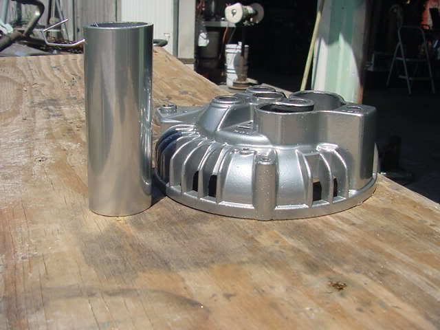

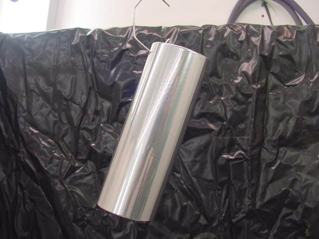

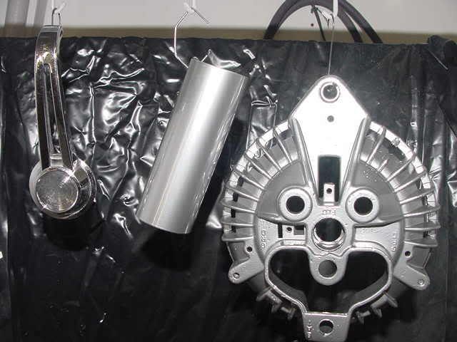

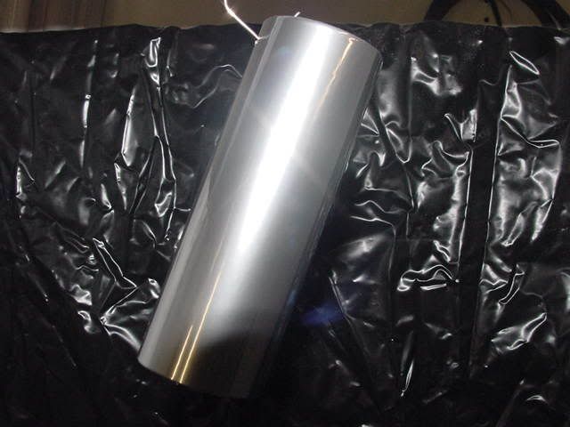

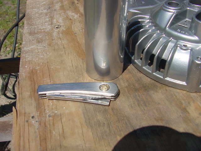

    I just want you to know I did it with my PRO CRAFTSMAN GUN If I had put the handle up beside it before the clear I think it was almost there! Good work PBTPounders The first two have no clear. Clear always take some away all the rest if they will upload do have clear.

        Ask your wife and she will help you This stuff is awesome if you didn't have to clear it!!!!!!!!!!!! I did it in my small Wally world oven with the glass door and saw it come to life and no way to take a picture of it to show? Just an't gonna happen as they say
        Its was nice to mess with it because I having to try to get the custom bike to the epoxy primer part and done so the customer can do all the fitting before it comes back for painting. To much damage on this new bike frame to powder it and one part has already been sent back because it was a 1/4 " off and would screw up the seat! $4500 and I think the builder could have done better and my bill if I decide to charge them is pushing a grand just doing repair! But I have the finish and paint to go yet. I think cars or easier!

          Duke, the pic's look AWESOME I am sorry for the delay in responding I am on vacation and was traveling when you posted :P

              hey,she deserves a vacation too you no. .....that chrome is sick looking.i'm going to have to get me some....

                Yep get you some that chrome you not going to beleive what you see after the flow just unreal how it comes out and now if the black chrome looks as good over it as it does over real chrome we will be in WHOPEEEEEEEEEEEEEEE we can do a coat thats unreal over steel? And that is going to be worth some bucks for US!

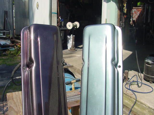

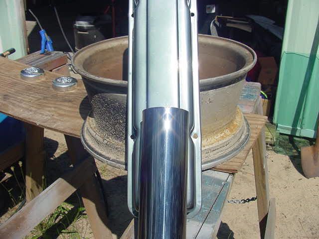

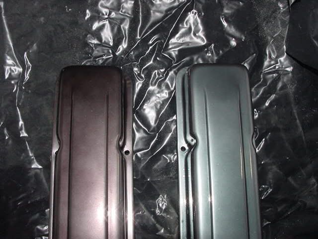

                  Well I tested the ultimate chrome with Rosey's black chrome and the one we like EW black chrome and Rosey's is close to maybe norm but looks like EW just want do it unless it real under it? Now to take these valve covers and do the in texture and wrinkle. They were old chrome ones that my friend said here do them for show. For the EW to work the chrome has to be shinier I guess? Don't know if you could polish it out more and get it? But would be a lot of work to do a motor cycle frame + parts that way? And then maybe either polish out the black chrome or shoot a clear and polish it?
                  Not sure if any one is going to do any testing or not but if we could get it perfected it would be worth a gold mine I think!
                  Duke
                  EW BC over real chrome small pipe and EW BC over Ult chrome
                  Rosey'e BC left and EW BC right over Ult Chrome
