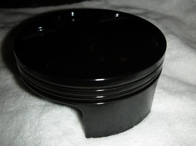

    Well, I managed to find myself a toaster oven today. Which meant time to try out my new gun. Had a few odds and ends laying around begging to be a different color. I blasted a piston, stuck it in the oven at 400 for 20 min or so then cleaned it again and shot it. I'm pleased with the results. A little orange peeled, but passable for the first try, I think. What causes orange peel? Not bad orange peel. You can only see it if you look at the reflection a certain way. I snapped a pic, but the lighting wasn't great for snapping a close up pic of somthing glossy black. Thanks to all who have offered advice. And thanks to all those who did more than offer advice. Tomorrow, I'm going to try to shoot some of the chrome with a clear coat. Advice on that would be welcome.

    Ok, so either try less powder or more powder, got it! I'll play around and experiment tomorrow. When you say heating the part too slowly, I'm not sure how to control that. Do I put the part in the hot oven or in the cold oven? If the instructions for the powder say 15 minutes at 400, does that mean 15 minutes in a 400 degree oven, or 15 minutes after the part hits 400? It too long better than not long enough?
    For the chrome/clear, I'm guessing I spray the chrome like normal, then spray the clear while the chrome is still hot? Any surface prep considerations with the chrome? Does the part have to be extra smooth or is the surface left by blasting smooth enough?
      You want the start the timer after the part reaches 400 degrees.

          Looks really good to me, nitsuj. Remember that some powders will just inherently leave a certain amount of orange peel. On the mirrors, its likely a bit too much powder causing it.
          When you to to shoot the clear over your fully cured chrome base, just let the part cool down some before you try to clear it, or you will likely get too much powder on it. If you shoot it totally hot, you'll notice the powder will flow instantly, and it is very difficult to judge how thick you're getting it until you see it start running. You can give it a very quick once-over while it is hot like that, then let it cool down a bit so you can see the powder sticking and apply until you get a nice even frosty white color. Cure as normal. I have better luck with clears if I don't go too heavy.

            also, keep in mind that the heat-up time should be gradual to allow the powder to flow out slowly and smooth

              Not happy with how the chrome turned out. It's not terrible, just not really shiny. But maybe I started with too dull of a piece. I also managed to get some dust in it somehow. That was my fault. Oh well, try try again.

                          I think the bag said extreme chrome or something like that. It was dull before the clear. I thought the clear would shine it up. Don't get me wrong, it's not terrible. If I wanted a silver part, it would do. It's just not chrome like. I'll snap a pic later. I've shot 2 more colors since then. Both of those turned out ok. I sprayed a silver and wandered if you could wet sand and buff it to a higher shine. I didn't work well for me. What I'm really impressed by is how much of an imperfection in the substrate the powder will cover. With paint, you can see every mark. The powder really hides a lot.

                            The only colors you can wet sand and buff with any success at all are the clears, translucents, candies and solid colors. You can't do silvers, golds, chromes, or metallics (basically anything with metallic content) unless you've cleared over them (then of course, you're doing the clear).
