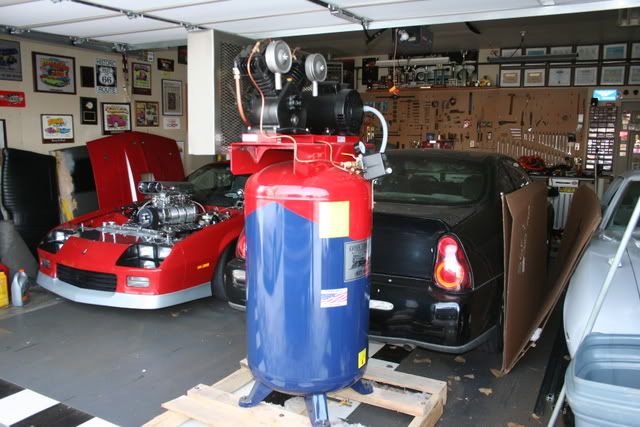

                        I just got this one from Eaton http://www.eatoncompressor.com/page/page/504747.htm a few weeks ago.....good price,great service, prompt delivery, 5yr warrenty plus the head is rebuildable....works great so far but the real test will be when the new blast cabinet gets here from his brother at BadBoy lol.
                        MY SOAPBOX:
                        To make it even better these (Eaton & BadBoy) are two family owned businesses in Ohio......I am making every effort to keep my money in the U.S. because #1 I know that will help the economy if I do it .......if everyone would do it we will get through this better and faster. #2 unlike the bailout I know where this money went lol.

                            One other thing to add....since they under drive the head it is one of the quitest compressors I have ever heard, which was another one of the reasons we bought it.
