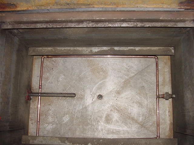

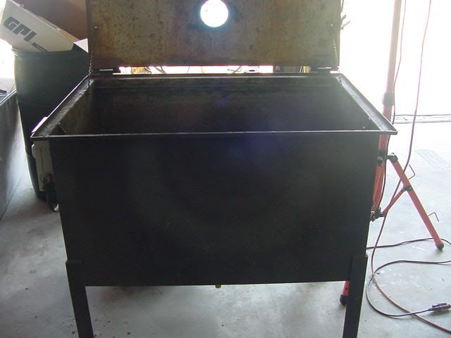

              All I want is a dag filter set up for my dag stripper tank and I will be happy for a min or two??????????????
              This is what I have posted.
              What type of filter system are any of you using to clean your stripper. Like in the 50 + gal range. I am looking for a filter that can be cleaned if any one knows of one?
              The PBTP stripper takes off powder in sheets like 917 does so I have to place a wire mesh in the bottom of my tank to help catch what I would miss dipping it out but what I need is a filter to help clean the other type paint products that dissolve like the 1012 does in small particles? I need to come up with an affordable recovery system. I have a parts washer pump coming in and not need to fig a way to clean the stripper.
              Any Ideas?

                Picture of the stripper tank>?

                    I guess you got your answer. But what he forgot to tell you was it also all depends on if I need a quick answer or just bull sht and him and I can do that real well even to the point I forgot why I called
                    Just posted some more info and ideas and pictures on EW and at least now I know who you are now. At least the old goat CPC tries to use the same name

                      DUKE!!!!,
                      Well after my first 30 minutes of autocad in the morning I have some ideas.
                      Lets not over complicate this....
                      Make a regular frame out of box metal or steel to fit around the inside of the tank. Attach a fine metal mesh on the top with brackets and screws. Attach 4 eye bolts on each corner of the frame. Attach chain to the eye bolts on the left side and a new chain to the eye bolts on the right side for handles.
                      When you want to filter just yank up on the chains and it should catch everything.
                      If you do not understand I can draw it.

                        He already has that for the large pieces of stuff, but what about the desolved particles he wants removed from the liquid?
                          Why does he need to take out the smallers items>?
                            Why does he need to take out the smallers items>?[/quote:3k67amzb]
                            To keep it cleaner. Just doing your hooks in a jar puts a lot of mess in the bottom and quick so if you put in some painted wheels you are going to have a lot of stuff in the bottom and quick. Carlson Did you see the picture of the tank I posted on EW?
