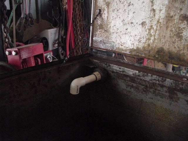

    Tank with Pump and Filters
    It will self prime water with no problems so hope it does ok with the stripper and then I find out about my filter setup I have. I will try to get all the powder coated stuff out first and then when I cut the pump on any that I miss will get caught in the first filter and not get caught in the pump and the finer filter that I wanted for paints that dissolve to small particles. The first filter has a bypass and the second one does also just in case so maybe the pump motor want burn up. But when I hit the switch I will stay with it for sure so I can be ahead of any problem? I hope!
    I have also did a lite insulation of the tank and have the lid so it will seal a little and also have a dryer vent set up for fumes out the top and a small 110v 3 1/2" blower for placing in the vent line so it will take the fumes out and through the vent that will be 10' up.
    Now all I have to do is start pumping over the PBTP stripper and hope I have it all sealed up and ready to strip body parts Oops Parts to be coated

    Re: Where Oh Where has our Buddy Duke Gone?
    DUKE!!!!,
    Well after my first 30 minutes of autocad in the morning I have some ideas.
    Lets not over complicate this....
    Make a regular frame out of box metal or steel to fit around the inside of the tank. Attach a fine metal mesh on the top with brackets and screws. Attach 4 eye bolts on each corner of the frame. Attach chain to the eye bolts on the left side and a new chain to the eye bolts on the right side for handles.
    When you want to filter just yank up on the chains and it should catch everything.
    If you do not understand I can draw it.

    All I want is a dag filter set up for my dag stripper tank and I will be happy for a min or two??????????????
    This is what I have posted.
    What type of filter system are any of you using to clean your stripper. Like in the 50 + gal range. I am looking for a filter that can be cleaned if any one knows of one?
    The PBTP stripper takes off powder in sheets like 917 does so I have to place a wire mesh in the bottom of my tank to help catch what I would miss dipping it out but what I need is a filter to help clean the other type paint products that dissolve like the 1012 does in small particles? I need to come up with an affordable recovery system. I have a parts washer pump coming in and not need to fig a way to clean the stripper.
    Any Ideas?
