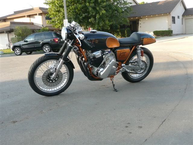

      Damn, I guess I'll have to spend the time polishing, then. Based on what I've seen with clear over chrome powder, I doubt a candy or trans over chrome would fare much better.
      Also, does anyone know what this copper colored powder is?
      It's oh so coppery! I sent an email to Carpy, but who knows if he'll fess up!
      -Deek
      (This is the finished bike.)

          If its a steel part you dont want to polish it. I actually shot that color over extreme chrome and it looked pretty similar just not as reflective.
            Re: Closest to brass
            You can't tell in these pictures, but I've seen the bike in person and I'm almost certain there's a metalflake or something underneath that, and the color must be a candy of some kind.
            The frame was definitely not chromed (powder or otherwise) before coating.
