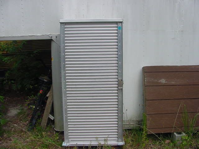

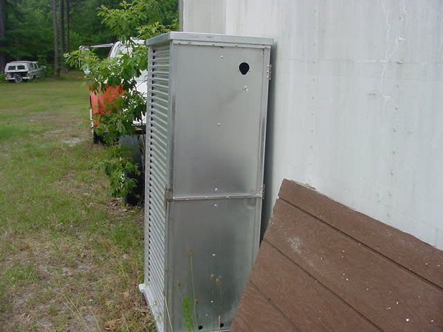

    I have all I need to make it an oven except on how to insulate it? Its 18"w x 30"d x 60"h It was a food warmer. If I could find a backed type then just maybe I would not have to build and outer shell for it? It all aluminum. Cost more to go get it than I paid on the bid on the gov auctions site?
    Got any Ideas?

            Meanwhile........back to your oven question - you'll need steel, galvanized or stainless for an internal liner to sandwich hi-temp insulation. Even then, the aluminum will suck up the heat like nobody's business and warp like a mofo. Seems like an awfully small oven to put much money into just for the sake of calling it a p/c oven??
              Re: Would Make A nice Small Oven?
              Yep the aluminum part is really what I was wondering about. As a food warmer it does ok but when 400 degrees hits it is when it might get fussy. It was like a big steamer with a small tub in the bottom for water and the heating element.
              Maybe I will make it into a powder storage container. Its got wheels and easy to move and then maybe glue some insulation board on it?
