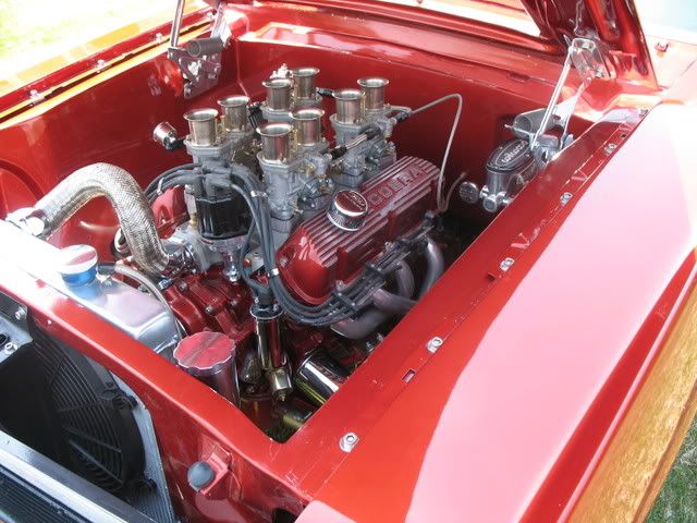

            Here is a pic of the motor. Currently is out and getting stroked to 347 and roller cam installed. Also changing all the motor items to black, silver and polished. Webers are getting coated black, intake silver, ect. It is in a 66 fastback.
