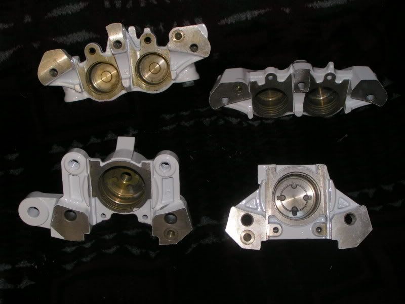

              This will give you an idea of what need to be masked and dont forget to plug all holes.
                Re: Cycle caliper price
                I use my accounting software to estimate jobs. Very quick and it always makes sure I get paid for my time, materials, and other miscellaneous costs. It also saves the estimate so when the customer calls back or stops by the shop I can quickly pull it back up and turn it into a invoice.
                Going off of your pictures the quote I gave before would be fairly accurate (for my shop).
