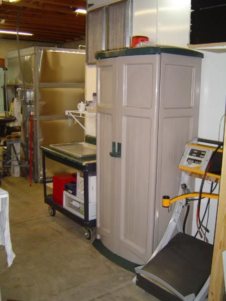

    Here is my new climate controlled powder storage room. Rubbermaid 6' X 5' plastic storage building with air conditioning. Still got some more organizing to do but its coming along.

    Very good idea - I think I would caulk all the seems and put some kind of seals on the doors if it were me. How much did that thing run? Get it at the depot?
      Re: Climate controlled Powder Room
      Nice Jason!
      How is the humidity? Here in FL that room would be damp. I guess it would work well for other states?
      Either way very cool!
        Humidity can be bad here at times but I dont think it would be enough to make the room damp. I do plan to seal all the seams and I was even thinking to spray that foam insulation into the panels to insulate them some. I bought it off craigslist for $65 just needed a little cleanup and it was ready to go. The one I was checking out out the Depot was about 1/3 this size and it was over $200. I'm not sure what one this size would be new.
          Thats a nice setup. I've been trying to figure out how to store out powder for awhile, this might be a good option. What temp do you keep it at?
            Not sure on the temp yet. We just got it up and going Thursday. Im probably gonna try to keep it around 70-75 deg.
            Thanks
            Jason
              I just checked out Home Depot's site and that size goes for 400+ So you got a smokin deal Jason!
                I have basicly the same thing only smaller (although I am running outa room fast ) since my shop is at around 72* all the time I just have a small dehumidifer in the bottom of mine.
