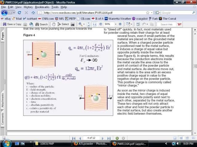

                            Thanks for the link Harleydad.Interesting reading,
                              Re: King Coat Video
                              I read until I came to this.......
                              It was all a blur after that
