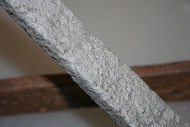

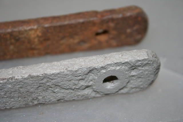

    I have some 100yr old parts off of a stanley steemer that are very deeply pitted with rust. The guy wants to reuse as many original parts as he can and is asking for two coats of wet black to smooth them out some. My question is what can I do to best insure the rust from returning since they are so deeply pitted. I am a little worried that as good as I can blast them I still will miss some small pockets of rust. Any advise would be appreciated Thanks.

      Steel parts? You really think you'll still leave pockets of rust? Blast really well, one step/no rinse phosphate, kl primer, apply the primer as soon as possible (sanding between coats as needed), wet black topcoat.
      Here's the one step/no rinse phosphate.

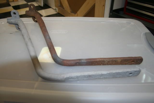

      Ya steel/iron bars.......these are the worst pieces (8 of them) they are fender supports I think........thanks Harley

          Those parts are REALLY pitted!
          I have experience wet-painting parts in this condition, but not powder coating them.
          This is the direction I would go -
          I haven't used any, but Zinc primer is recommended to PREVENT rust - don't know if it would hold it back from coming through in a situation like this. Check with King. With that heavy of pitting there is definitely rust hiding in there somewhere that will resurface...
          From what I have seen the KL primer should help you level-off the surface . You may have to prime/sand, prime/sand, etc..., to really level it out. Depends on how much he wants to spend on it I guess.
          You could do some sanding or light grinding to try to reduce the depth of the craters (knock down the peaks) before coating also.

                    You'll be doing ALOT of coats even with the KL primer as bad as those things are pitted! I like the wrinkle idea. Grind a little, prime alot, sand smooth and go for the wrinkle. Show the cust a wrinkle piece and explain it'll help cover the pitting, ya never know he might go for it!
