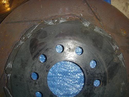

    Hi All, I am re-engineering a set of rotors from a brake kit. The original rotor hats were anodized aluminum. What happened was the anodizing wore off and bare aluminum contacted bare cast iron. That, plus the salted roads in the winter caused galvanic corrosion of the aluminum, which led to these nasty looking cracks!!
    I plan to machine new aluminum hats (using 7075 t7351) and to improve corrosion resistance, I was thinking to anodize the hats, THEN add high temperature powdercoat to it. What do you think of this? The hat does see lots of cycles of heating/cooling, but it doesn't see THAT much heat compared to the cast iron rotors.
    What do you guys think? Will the powdercoating stand up in this application?
    looking at the picture, i am going to machine a new "hat" which is the black center piece.

    Is this a special rotor that you can't buy any more? If not, why go to all that trouble? I'd buy a new set, blast, coat with regular powder (which should hold up fine according to a few guys on here who do them regularly) and be done with them. Good luck either way. And to answer your question, high temp would probably work, but I don't think it would be as durable as a regular powder. To help with the corrosion, use a good powder primer before your final finish coat.
