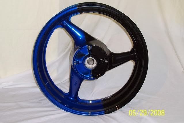

      +2.. This Type 2-Tone ?? These wheels were actually 4 colors.. Chrome,Candy blue,Black & Clear..

        That wheel is differant, kinda ying and yang effect.
        Looks great!
          that looks killer, the way were spliting it is from side to side so on one side of the bike its yellow and on the other pink (its for a stunt bike so its allowed to be retarded)
