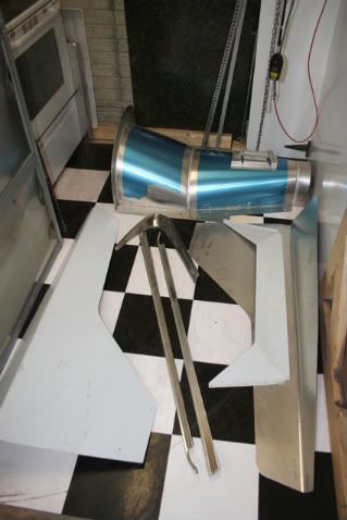

    I am getting use to pricing the small stuff but would appreciate any input on these larger items

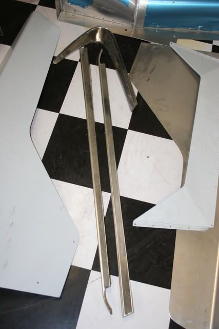

    All in Satin Black, the trans tunnel (without shifter mount) will be top only the other three panels will be both sides....... plus the four (still need to get the other corner piece from him) 72 charger window trim pieces.

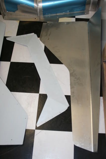

    The white on the flat panels is the protective plastic wrap.......they are all new panels.

      I would say $325-350.
        Re: Some pricing help please
        Thanks Jason that sounds good..........for some reason I just cant get numbers to land when I look at the large flat stuff lol.
          Depending on part condition, $3-$6 / s.f. will get most of the work in the door. The low side is for minimal prep, the higher for the rusty chit. If you can settle on a s.f. price that you can live with, that's about all you have to quote customers - let them do the math from there.
          It helps sometimes to visualize a single square foot of sheet metal...how much would you charge to coat both sides? Again, depending on the prep required, anywhere from $6 to $12 based on the above s.f. pricing.
