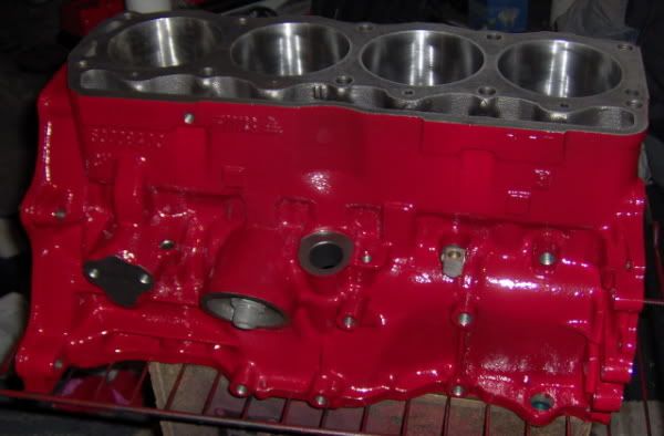

    Has any-one had any problems powder coating engine blocks,due to the heat????

      You won't have any integrity issues, but p/c work should always be done prior to machine work. The temps we use for p/c can take some precision machine work out of tolerance on a competition engine. Make sure you customer is aware of this and that he understands his machinist can handle a p/c'd block without farking it up.

                    There's a huge difference between what I am familiar with (Aircooled VW's) and the current Porsche parts. But, I know you shouldn't ever Blast a VW case. Chemical cleaning only. The only part of those engines that are good for blasting is the fin areas on the Jugs and heads. The rest should be left alone. Coating them is no big deal, but as stated above, machine work should be done AFTER coating. At least have the machining that has been done already checked after coating. Masking is pretty important too, I'd say.

                        I have coated several engines.
                        I suggest coat before machining.
                        mask well for blasting, and coating, and out gas well

                          I was thinking about doing this with my block but my friend told me the powder would not hold up unless the block was new. Since my block is older and has had oil on it in the past (iron block is porous) I shied away. Is my friend mistaken? If so I'm game to getting mine done. It looks really nice.
                            Re: Engine Block
                            Yeah, you can still do it after oil. You just have to offgas the block.

                              cook it for about 1 hour @ 450*, should be ok
