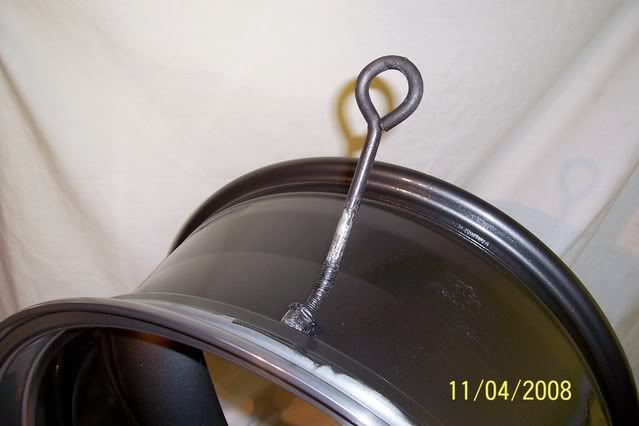

          Most wheels i hang with a 6''-8''Long 3/8 I-bolt threw the Valve stem hole.. I get them pretty cheap in the fastener section at the local Home Depot...
          Pic...

              make sure if you use the bolt through the stem hole to make sure they hang straight or a little in on the bottom, if you have a heavy hand powder can accumulate on the lower lip if they are not straight.
