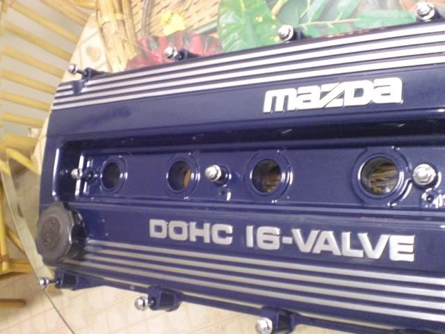

                  LOL I started working tonight and realized my lowest grit # paper was 220 so it took forever...this is where I stand. The mazda logo is done with up to 2000 grit and polished, the rest is still being worked on and is only @ 220 right now.
                  Thanks for all the help guys, PS are most people on here powder coating for a business? I personally just do accountanting and this as a side job right now, but everyone else I see on here works for a shop. :P

                      Awesome to hear...I will post up finished pictures hopefully today/ tomorrow. Also is there anything a person can do if you slightly hit the coated area and it took away some gloss, other than redoing the valve cover? Thanks

                              Forgot to post pictures, using 100 dry grit is great to start...personally I had bad experience with wet sanding it due to it pulling up the tape. But I used 1000-1500-2000 all in the end with wet sanding and it worked great. Thanks guys
