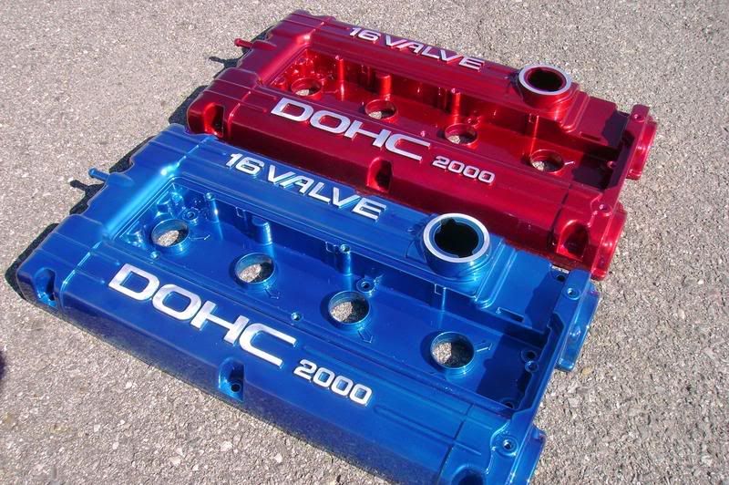

      I never use a chrome for my candys...The valve cover you have posted photos are of my v.c done in metallic silver with OCC candys red and blue.
      The trick is to shoot with a metallic silver fully cure follow with a candy @ 150f warm..

        Re: applying multi coating (translucent/candy blue over chrome)
