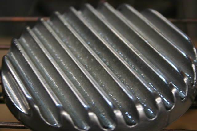

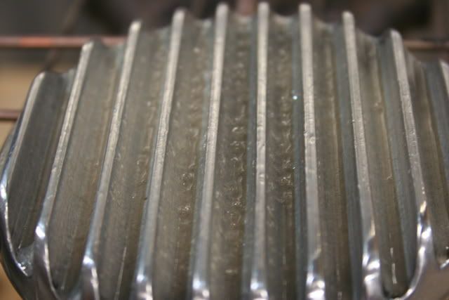

          Lol what good timing for this thread...... outgassing at its finest....just pulled this from the oven, PBTP Diamond Clear Acrylic over brand new raw aluminum tripower air cleaner top. Sorta figured this might happen so I just did one of the set with no out gassing to see if it would. Stripping as we speak and next round with outgassing first.
          Shot with a GEMA Optiflex-C
          settings were
          50% powder output 4.5 Nm3/h total air output
          10uA 100 kV
                    You are very wise to minimize your exposure by doing just one....
                    settings were
                    10uA 100 kV
